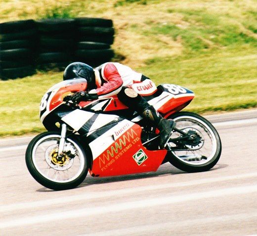

Mike - I believe the De Villiers bike is still available, on the other hand I was speaking to the man who won that Bantam racer and he said he wanted to return the bike to the track, I don't know when and I don't know where but he said he intended to restore it and possibly do sprinting/hillclimb with it. T'was a steal I will admit!

think this is the bike you mean tim

Yes, that's the one Dan. if you have the money Luke go for that, haven't seen it in the flesh so can't give you a perspective but judging from Mike/Derek and other racers it might be what you're after - certainly beats spending a few years in my case building or as I call it getting nowhere! Ha.

On that picture of Martin Nash 'd'Villia, dan put up, he built it himself, a super nice guy, his bike is very reliable, and its a very fast Bantam, even now with the right rider "in my opinion" its certainly capable of winning races, no doubt about it, I remember Martin being almost 10 seconds behind Mike Powell at Pembrey, having stalled it on the line or something like that but by the end of the race it was a different story.

Martins bike will be a great buy for someone - its really top notch!
