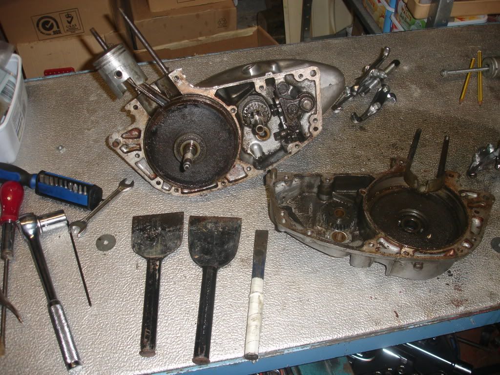

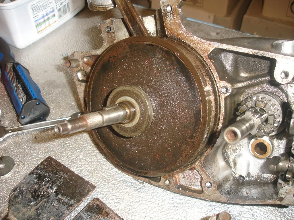

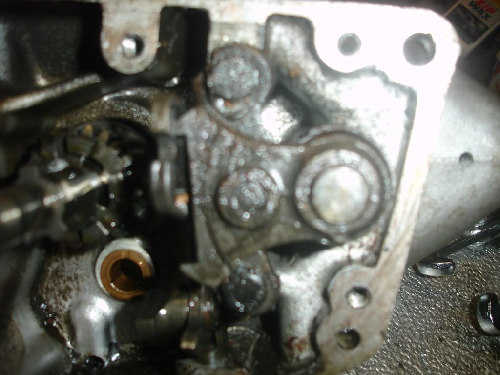

Just got your email. Hope this is okay on your part. Thanks for the help so far and to everyone for getting me this far so far, what nice people you all are.
Got some good news, after about 4 weeks of trying to split the cases, and turning to many local riders, I found a hidden screw which FINALLY let me split the cases. It was hidden under the gasket... !! Took it off, got some of Dad's wallpaper remover scraper and managed to take the left side of the engine off.
The cases are in good condition, crank is perfect. No rust at all apart from the con rod and the packing rings. Easily replaceable. Gearbox is in absolute *mint* condition. After 50 years of wear and tear, I can't see a chipped tooth, every gear has the correct teeth.
Thought I might include some pictures;
returning to bantam racing - Page 2 DSC05199
returning to bantam racing - Page 2 DSC05203
The gear lever shaft is stuck. I'll see what I can do with that. The dogs look like they're free moving but are stiff as bricks. There are no wear on this part of the internals. Diagnosis anyone?
returning to bantam racing - Page 2 DSC05204
As you can see, pretty average cond. for 50 years.

Great pic's its like photographic overload!!
So some are of your bits and pieces, some at BTW's,some casual and some at your dads?
In that order-ish....
Your place .... Your footrests are mounted on the swinging arm!? Why?
Your pipe looks good - is it effective? Been tested?
Why have you cut your frame to inspect the rust build up?
Whats the crankcase reed water cooled outside stud motor doing then? is it a runner?
Brians place .... A 12port Reed vavler - Wow - where there's holes there's bridges! Thats alot of work -Amazing.
The gearbox pic's amazing again! Is that a 3speed box? Or a 3sp made to be a 4sp? If its a 3sp its legal!
if its a 4sp is it legal on a 175???? I notice the sliding gears have swapped shafts!!
I think there is alot advancement going on in sprint circles at the moment where as in Bantam racing everyones
keeping it simple and (hopefully) reliable.....

Brian is that a roller bearing instead of a ball bearing?
Picture with a red cap gearbox mainshaft?
Mike
