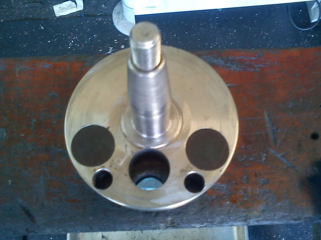

heres my crank our idea before rossi!!!
PostSubject: Re: Heavy Crankshaft....   Sun May 01, 2011 9:21 am
Rob your crank looks the same size as my 003 crank?? Yours gets you off the line quick or is it your greater cubes??

Derek in the 20yrs?? you were away from bantam racing I have changed my cranks
The chamfered cranks were replaced about 10yrs ago - the inertia was to low Laughing Laughing
This is my 001 crank(half) was in bits hence no rod etc on it....

Hi, Robbie and Mike,
Any chance of getting values for diameter and weight for your respective crank assemblies ?
I can then do some maths and make an informed judgement on this whole ,interesting,crank debate .
However , i fully understand if you both wish to keep your "secrets" to yourselves .
Regards , Trevor

PostSubject: Re: Heavy Crankshaft....   Tue May 10, 2011 7:14 am
001crank is 96mm diameter and 2.3kg...
