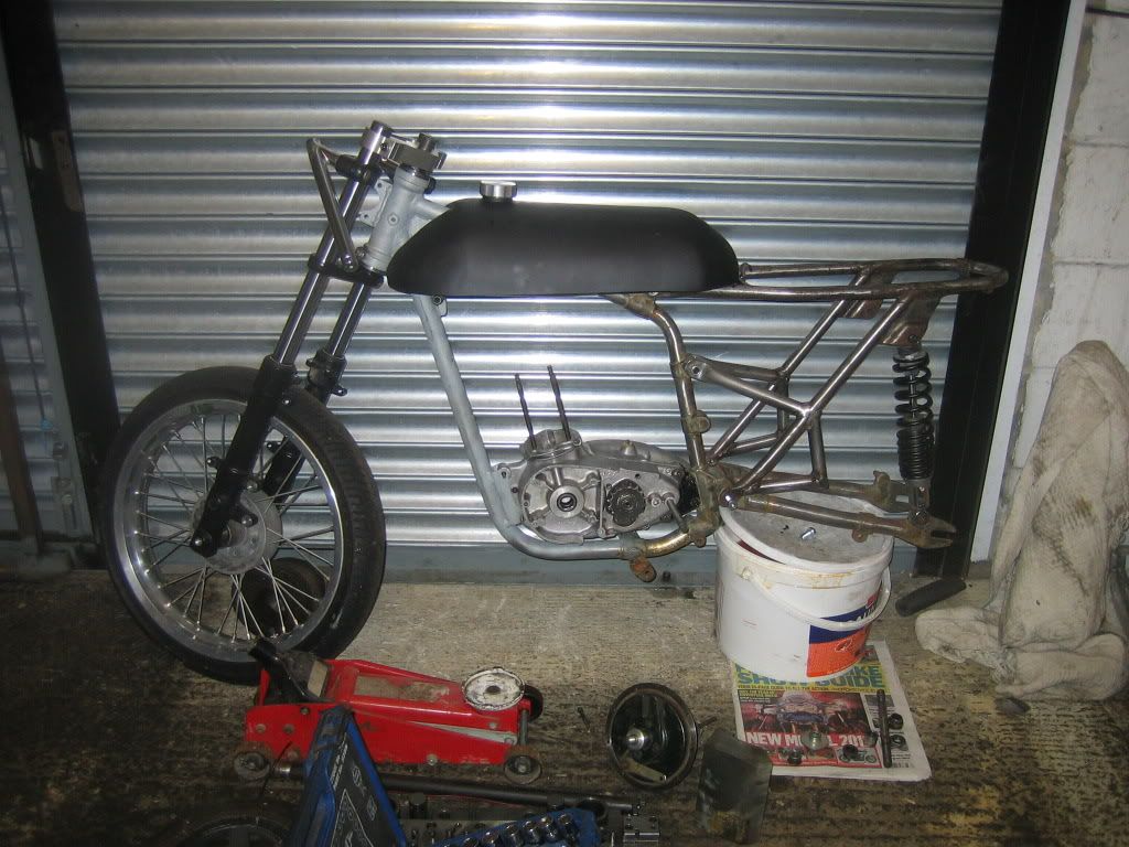

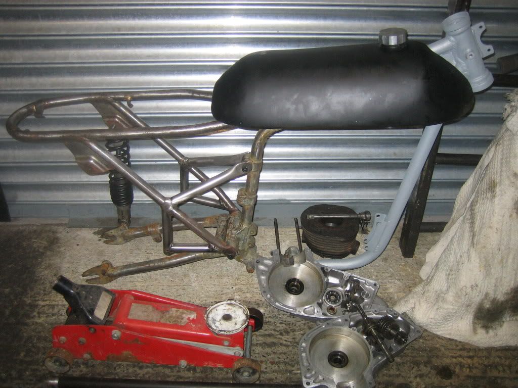

made a start on fuel tank , need to weld in the tunnel to clear the top tube, rear set part done and converted the engine to left hand gear change as i don't think i'll be able to change a habit of a life time

sorted a front wheel , and spaced out the rear hub
making rearsets and exhaust soon

Hi Dan looking good, is that your rear hub on the floor?
If so its a D1,3,5 hub and therefore will be to suit a 40 hole rim (all long spokes).
D7,10,14 hubs are better as they have a shoulder for the sprocket to butt up aganist (so you can
cut them in half for quick sprocket changing.
D7-14 are 36 hole(18 long and 18 short spokes).

Sorry Mike,
Not often I would disagree with you, but early Bantam hubs are 36 hole and later are 40 hole

it is an early hub with 36 holes, i've made a mod to the brake plate to allow the cable to be fitted and to move with the hub when the chain is adjusted , and i've got a modern bolt/axle and normal spacers and sealed bearings fitted too , plus a tie bar to keep the brake plate still , and i replaced the heavy steel plate that was riveted to it with an alloy one

Me-thinks you are going to have a few problems with that hub!
How are you going to attach the sprockets without the small bolts shearing off? I think you are at risk of an accident. Consider changing the hub to the later D7 for your own safety!
The Later hubs allow sprockets to be split so that they can be changed between races easily as well so it is an extra advantage.
Get to meet one of the guys racing and it will help with the explanation.

PostSubject: Re: a new member and new builder plus progress so far    Thu Nov 24, 2011 8:05 pm
are the early hubs no good then?
i guess from what you say the later ones have a larger area for the sprocket to bolt to?
Number of posts : 450
Age : 64
PostSubject: Re: a new member and new builder plus progress so far    Thu Nov 24, 2011 8:53 pm
No one uses the early hubs for racing (too dodgy and difficult to use), and yes there is a better location area for the sprockets on the later D7 onwards type of hubs. They are generally fairly easy to obtain from ebay etc, make sure that the bolt threads on the new style go right though to the back of the hub (do a re-thread) and your sprocket screws (we use Allen head type 1/4 bsf thread) just show at the back of the hub with the sprocket fitted. This way you get maximum strength and there will be no breaking of the casting where the screws go through.
