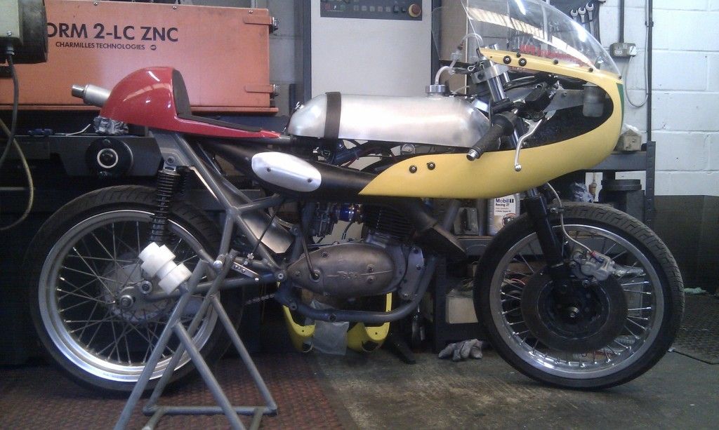

Hello Derek , if you click the bike it'll play a video, then you can see the side view

but I can not see the barrel, is it a 125 / 175 - is it iron or cast alloy, not one of brians, and if Imay say what a great job you have done,
it certainly looks the dogs tagems,
I love its historic look too I am very loud against modern fairings, think they just dont do our class justice or the riders/ tuners who put so much effort into making them Fly as many of them do now days,
I feel with the lower half its will look even more like a original racing fomula bantam, of the ciorrect erra, sounds gerat too,
what a great job.

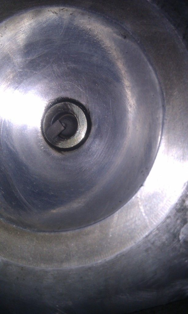

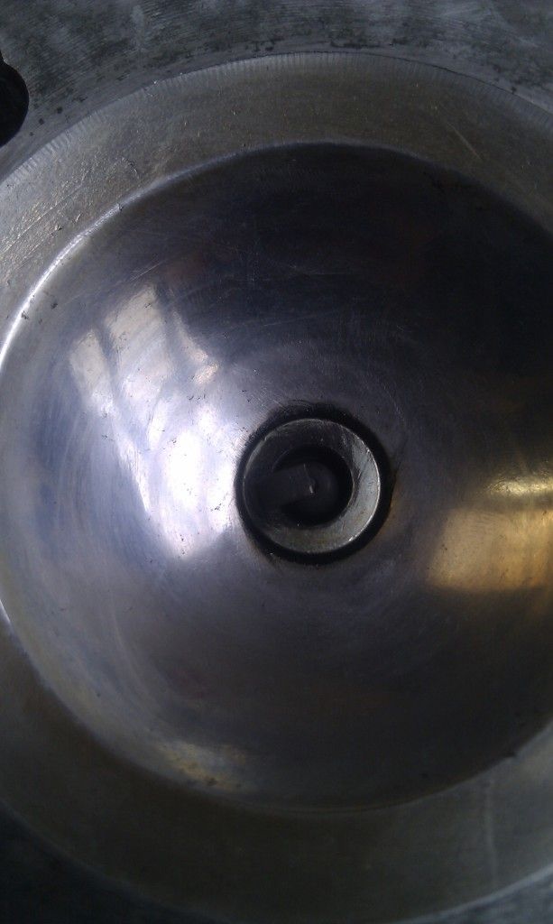

out of interest i took the head off to have a look to see how its was doing, it all looks okay to my untrained eye, a little oily this wipes off with a finger tip , so far its not really been pushed rev wise, i have been able to do a dozen or so starts from a stand still but get to what i think is half rev's in second gear before i run out of room, what do more experienced eyes think?

PostSubject: Re: a new member and new builder plus progress so far    Fri Jun 22, 2012 2:33 am
Hi Dan
At the top of the picture of the head it looks ragged and burned as if you have had some detonation.
Detonation can be caused by a number of things - running weak, too high a compression ratio or too much ignition advance for the octane rating of your fuel.
Does the squish band spigot into the barrel ? If so the sharp edge may get hot enough to cause pre-ignition which has the same effect as too much advance.
Mick

PostSubject: Re: a new member and new builder plus progress so far    Fri Jun 22, 2012 3:18 am
hello mick ,
all the ragged bit you mention wipes off , its a run/film of oil , the squish doesn't spigot into the barrel its flat.
i wiped the head with a rag and took a few more pictures, to me it seem like it did when i put it together , and i would guess running rich , but thats only a guess as its so oily and wet, would you say its looks safe to rev it hard for a few laps? ,
i have run the engine a fair bit to date and has used almost 4 lts of fuel , i've stripped it down over the last month or two 6 or 7 times and stoned the piston removing any spots that looked like it was picking up and a light hone in the barrel. and today its got no more highs to rub , here a picture after i wiped it clean , not very good pictures as there were taken with a mobile.
PostSubject: Re: a new member and new builder plus progress so far    Fri Jun 22, 2012 6:06 am
Hi I think Mick is not refering to the head, deposits at all, this in my opinion can tell you nothing inportant,
Mick I feel is refering to the piston crown "" much more important in the mixture stakes, I have to say I agree with his prognoses, although I would ad you can see the meassls in the carbon on the piston crown too,
I would further add this engine will self distruct underload, if all you have been doing is running it up the road, thats if its left as it is, the only thing that is puzelling me me is the colour of the crown, I think it looks a tad on the rich side, and appears to be good colour, which would for me point to other things affecting this.
regards Derek,
mscutt
Number of posts : 96
Registration date : 2011-10-21
PostSubject: Re: a new member and new builder plus progress so far    Fri Jun 22, 2012 6:32 am
Quote :
Quote :
Ahh - in that case I would say its a bit oily Wink
I must say Dan its all looking very neat and well made. Well done and hope to see you out on it soon.
Mick

Hi Dan I'm confused about the way your carb is mounted. It appears to have a bracket above the bell mouth fixing it to the frame. This would defeat the purpose of rubber mounting it from the manifold, please explain.
Agree with Mick, it looks the muts nuts.
Number of posts : 362
PostSubject: Re: a new member and new builder plus progress so far    Fri Jun 22, 2012 8:34 am
Hello Ned , its a temp idea as the silicone hose I used to mount the carb is too flexy for its
Own good , I' ll be making the manifold again with a lip to help trap the hose on.
Thanks for clearing that up Dan. I guessed you would have a good reason for doing it.
