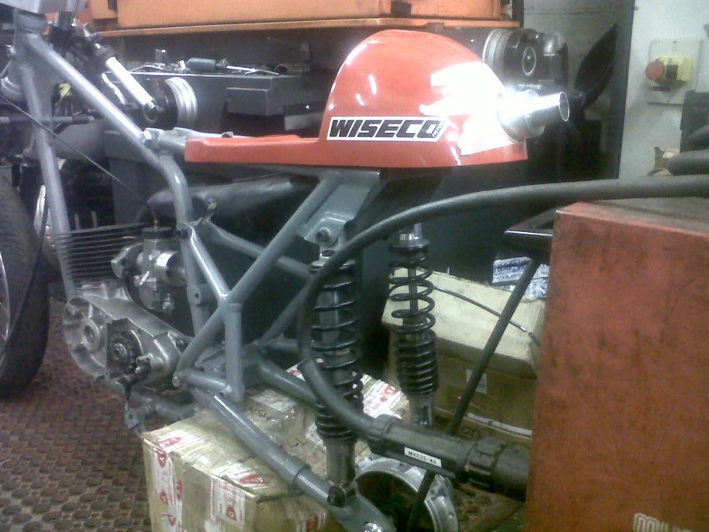

finally got a correct hub, finished modifying the frame and found a seat, got the rear brake and gear change sorted although its not fitted in the pictures .
need some spokes now, never bought spokes before, anyone have the sizes i need to ask for ? its a 17" rim , are just galv spokes okay?
