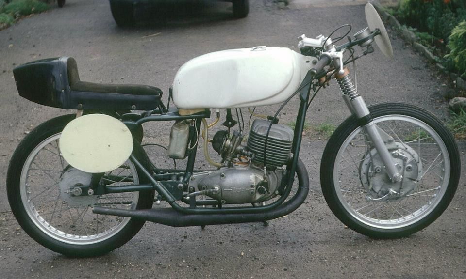

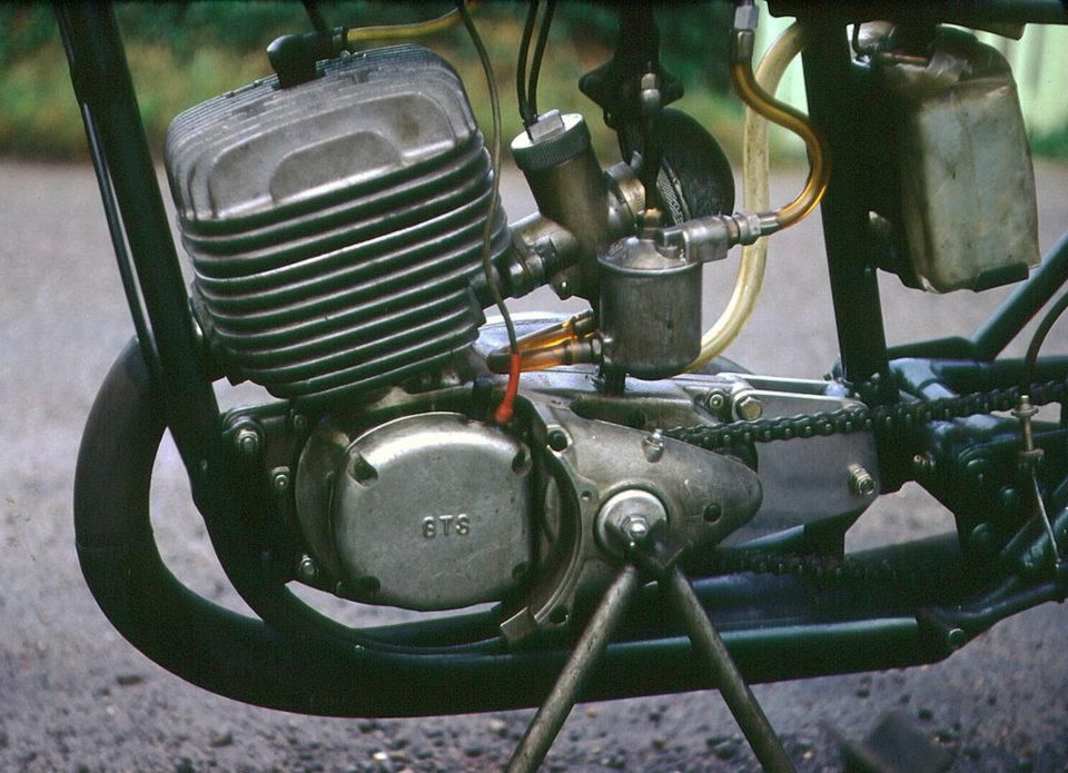

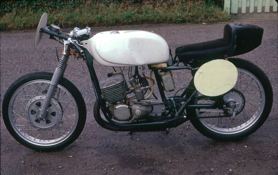

Hi all some more goodies from George
for some more info he is going through it and gradually loading to his face book page, I would suggest those with a face book page pop along to Georges page. some very intereting quotes/pictures.
George said:- on his face book page :-
The forks were from a Ducati model - this famous Italian firm was going downhill at the time (1970). But look at them now - producing fabulous bikes, Why the hell couldn't we have done that at BSA's? I'll tell you all one day, when I have time:-)— at Falfield, Glos.
George said :- My guess is that it topped the "ton" (100mph) easily... When I tested it, the acceleration was almost frightening:-) If only BSA's had progressed with this cylinder& head development for their most successful small bike. Instead, it was pushed aside for silly projects like a 3-wheeler for "Mum to go shopping". It failed.
Thank you George

Looks like the engine described in the Aussie Scott letter ?
