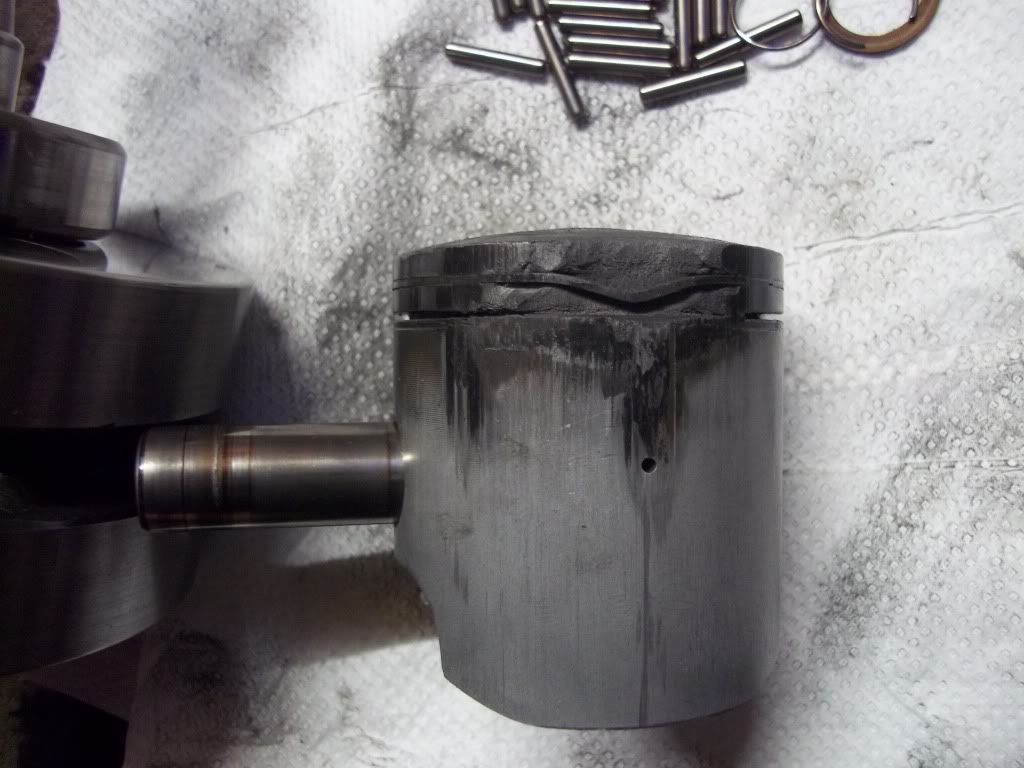

This piston finished race 2 at Cadwell but only just! I thought it had trapped the ring
in the grove as in race 1 but it was more serious -as pic shows, really struggled on
the last half a lap...
JB whats your diagnosis??
ps i know the answer....

PostSubject: Got a bit warm I think!!   Sat May 26, 2012 8:58 pm
Got a bit warm -- I think!
I´ll leave it to later `cos I am a Rodney Dümmkopf when it comes to diagnosis and for sure Derek will know what it was...
Was that a flywheel I saw next to the gudgeon pin?
Rodney D...
PS -- The evidence of first failure is destroyed by the running on afterwards -- you should have stopped as soon as the piston edge crumbled, attributably to ....???
It really is amazing how an engine keeps running with such damage. We had similar happenings with an air-cooled diesel: a glazed bore had the ring not transferring heat to the barrel wall which led to local overheating, such that the top land crumbled -- but nothing looking so bad as this. THIS IS NOT MY DIAGNOSIS OF YOUR MISFORTUNE MIKE I am just telling of a happening with an aircooled diesel where we were able to see the bore glazing. Obviouisly that would be destroyed too by your selfish attitude to finish the race and not contribute further to science!!
Knowing you never read more than two lines of long replies I know you won´t have read that bit about being selfish so I feel sure we are still friends??????????? .
JayBee for John-Boy!

John but at last your talking ,absolute sense for a change, yes I do know its quite clearly the ring has trapped in the grove more importantly why though ?
I think i can see why? tell tail.!
regards Derek John Betts ?
Come on then Mike what caused it ?

Derek knows....
But since Mike addressed me on this and HE SAID -- it was NOT ring trapping as it was in the first race -- something could have happened with a new ring for second race.
The ring trapping in the first race may --- MAY, I say -- have caused some bore glazing which Mike did not see which would have the new ring not sealing properly. In these cases the bore becomes devoid of oil and things get worse...
OR the new ring did not bed-in properly and the area of overheat resulted -- maybe with bore glazing and maybe not.
Or did Mike make another change -- besides just changing the ring....? That also includes something changed before the meeting which caused the 1st ring to get trapped? Change of petroil mix to less oil than earlier? Ignition timing or carburation change-- or some mechanical change ...??
A new ring in an already highly polished bore, from previous running, can be as bad as having a glazed bore but by what Mike has said -- the way he said it -- there is something else -- not a wrong size of ring surely??

Big air leak I think !! Ring nipped in race 1 and total destruction caused by not sealing the bottom of the motor rushing to get out for race 2...

Good idea MM ... you are saying overheating was why the ring got trapped in the FIRST race? Are you suggesting the air-leak is the same one for the second race?
Mike must be asked about the changes he made before the racing began and what he actually did after finding the ring trapped after the first race? If he put the same ring back after freeing it off it could well have overheated enough (duiring the 1st race) to loose its temper, radial pressure and ability to seal.

Right here goes.... reed valve motor used, went out to see if it worked as untested on a Dellorto34 - set up for last years piston valve motor(there i've used it again) seemed a bit lacking in performance - too rich. Went to start in paddock - would not start? lack of compression - stripped top end quickly with help from Tom and Arthur (My Seeley 7R & G50 supplier) Ring stuck in groove, freed ring refitted ring re-built top end but in a hurry and snagged the base gasket resulting in an air leak and picture of a ruined piston you see!!
Mike Mc ... did we have a conversation post 2nd race strip down?? If not well guessed Shocked
JB thanks for your input ... you can always pm me if you like?
Regards Mike

PostSubject: I was right...   Tue May 29, 2012 4:35 pm

PS added later --- Why did the ring get trapped in the first race (place)? Is it a common thing? I ask because I never experienced such with racing 2-stroke engines and wonder if trapped ring occurrance comes from engines running at higher speeds now than they did 30-40 years ago.
