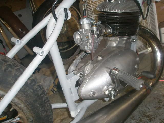

After two and a half years of collecting parts I fired my engine up for the first time yesterday, very satisfying and noisy and smokey. Had the neighbour across the street close to calling the fire dept. Strangely, the wife wasn't as excited as I was.
It is a 1955 D3 with a ported barrel, Mikuni VM30 carb and an expansion chamber.
It is running far too rich at the moment. Could anyone suggest a starting point for VM30 jetting?
Also I would like to take the (factory) head in to a machinist to get the head skimmed. I have seen heads machined to flat. What would be good starting point without affecting reliability too much?

PostSubject: Re: First start up!    Thu Aug 16, 2012 6:37 am
Well done Andy Your photo did not show whole bike but an I right in thinking it will be a plunger frame?

No, it is a rigid frame Making it all the more "collectable"!

Hi Andy,
If you are not using a "powerjet" on the VM30 then start about 280 or 290 mainjet and work down from there.
Powerjet is definately preferred as you will get a better overall balance.
If using a powerjet then start with 200 main jet and 80 or 90 power jet.
Expect the bike to run rich initially, and as always take great care when changing jetting.
