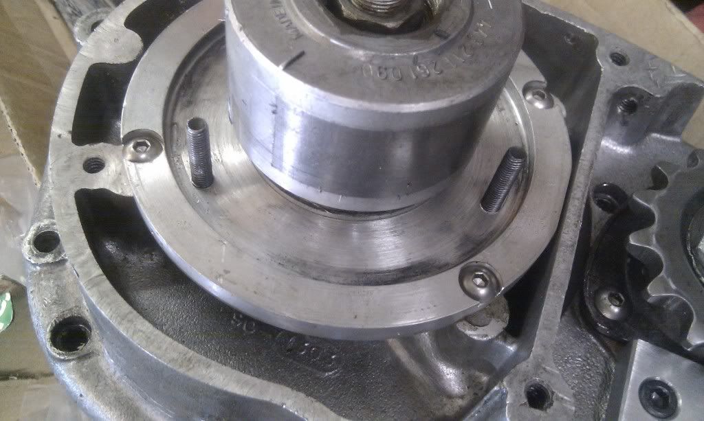

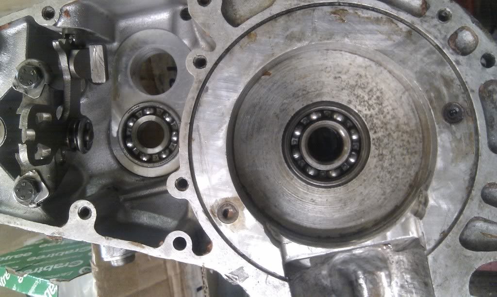

Here's some pictures to maybe help ,first is the crank bearings, only one per side with an oil seal

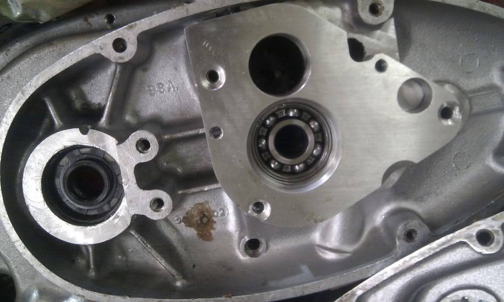

Next we can see the other side you'll notice the bearing up against the crank, it'll need a spacer behind it to keep here,
You'll also see the packing ring around the crank , here's a picture of the crank,

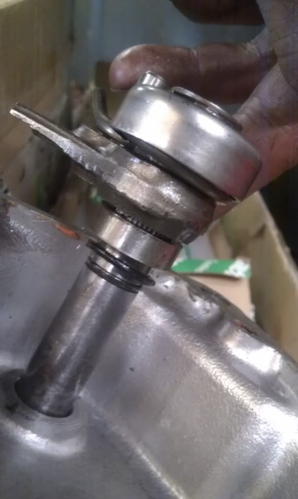

I made mine a left side gear change you may or may not want this , its all a personal thing

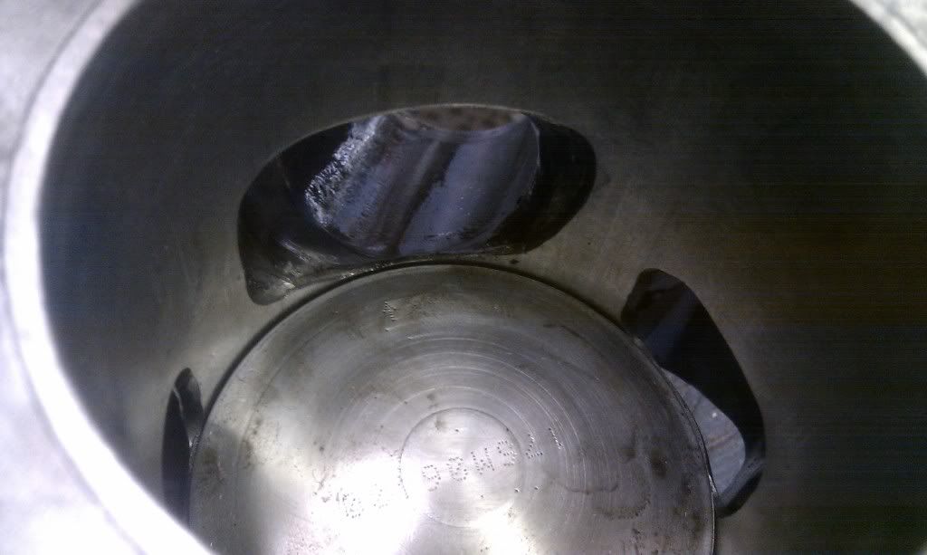

I've used an iron barrel, I do think now though an alli one have been easier
Also the ignition will need a mounting plate to be made to suit the type you'll be using

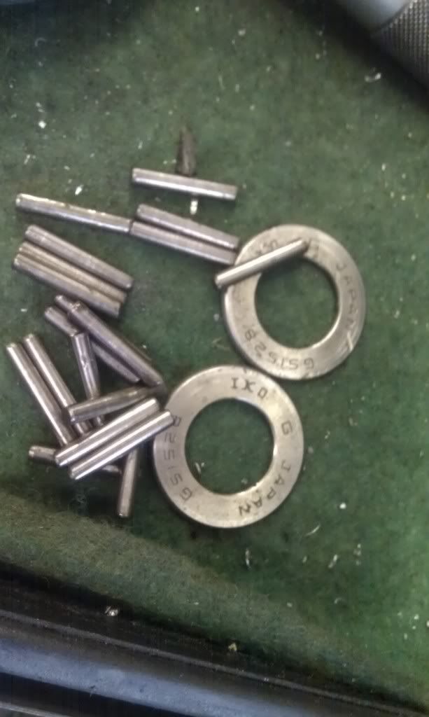

you'll need to build the crank with a new rod, I used a kx250 rod and wiseco 64mm piston, it make the little end bearing odd, so I used a crowded roller idea with two thin hardened washers either side of the rollers, I made mine from thrust bearing parts ground down to 0.5mm
