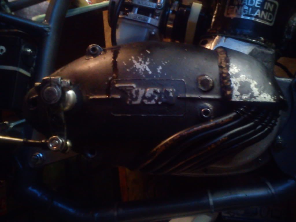

| HI MIKE on the point of clutch diameter not fitting the cases you see my clutch cover, your comments are very welcome. + or minus. ! | |
Number of posts : 1074 Localisation : Lincoln England Registration date : 2006-12-09
| Subject: Re: returning to bantam racing Wed May 11, 2011 7:12 am | |
| So is that a bigger than std diameter clutch in there? Or normal diameter and lots of clutch plates? like 7? or extra long springs? Lots of plates = lots of drag! The clutch needs to be "light and airy" 4 plate, 6/7 springs lots of holes = keep the revolving mass down.... and if it gets too hot do this....(see pic) | |
